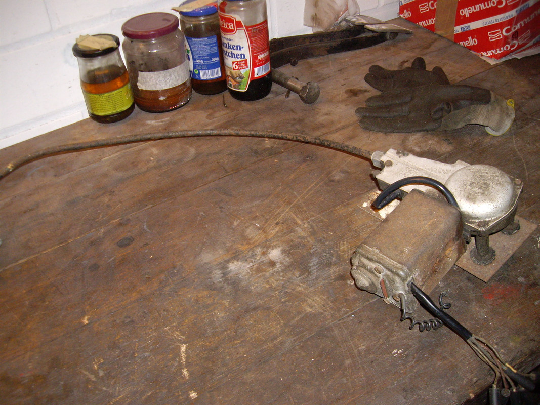

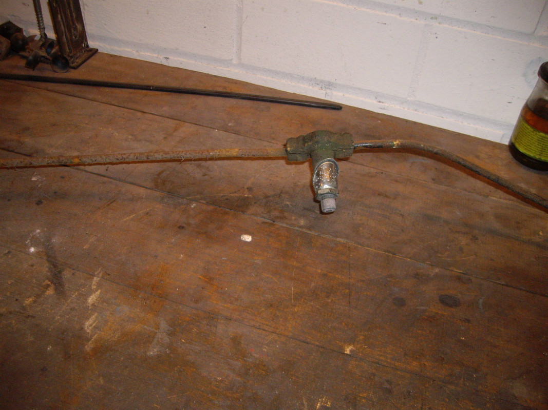

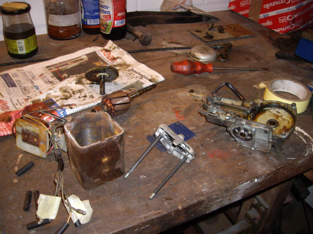

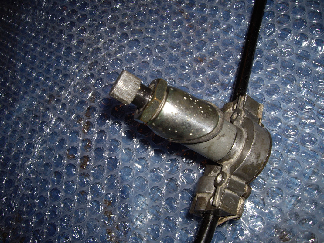

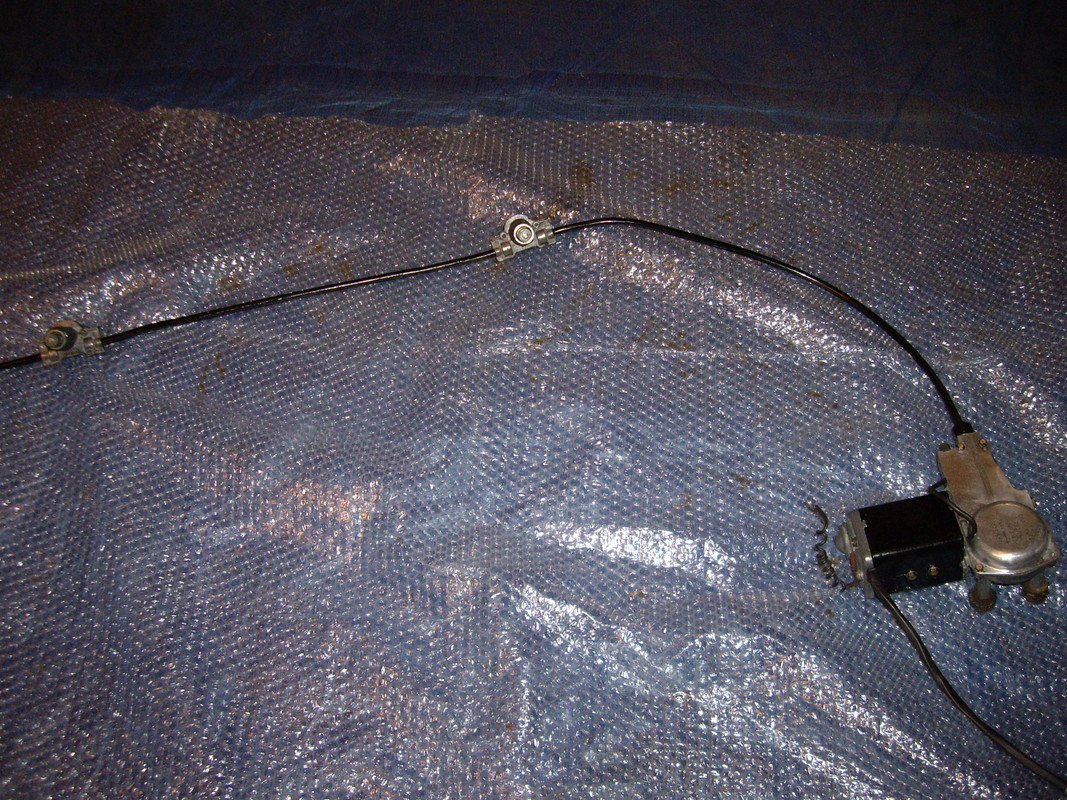

The overhauling of the wiper unit is nearly finished. How it looked before:
   Since the tubes were rusty I powder coated them.
   The wiper wheelboxes got new gaskets. What is missing is a new chromium coating of the outer brezel.

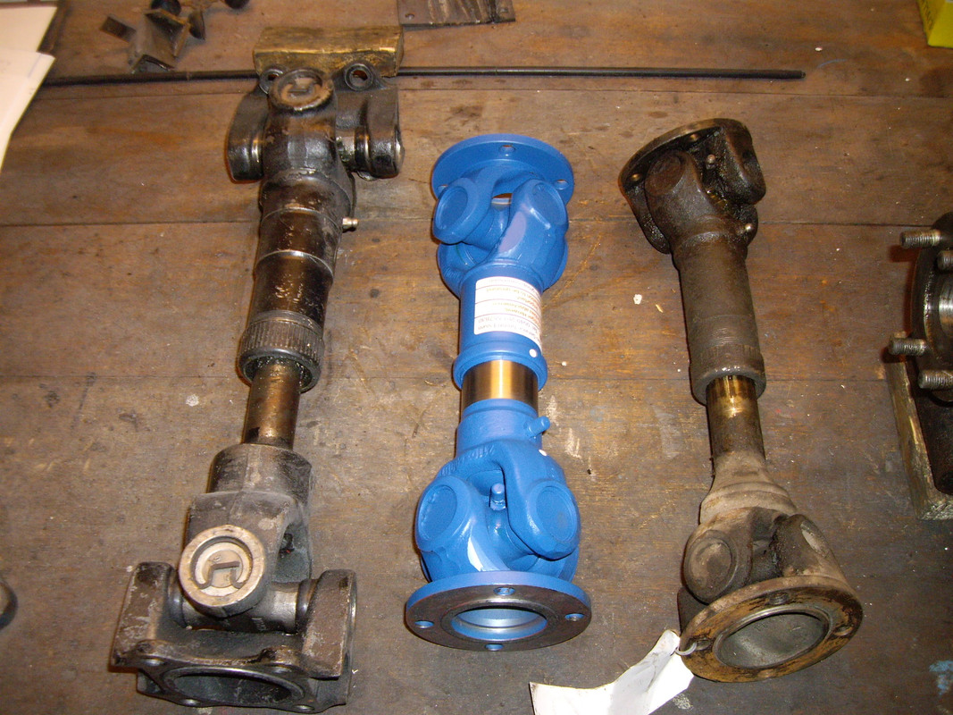

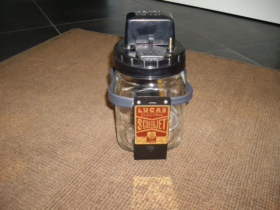

Today, it's a little bit like christmas. New parts arrived. I bought a repro Lucas washer bottle. You can see that's a reproduction but it's much better than the plastic bottles available so far. It looks nice:

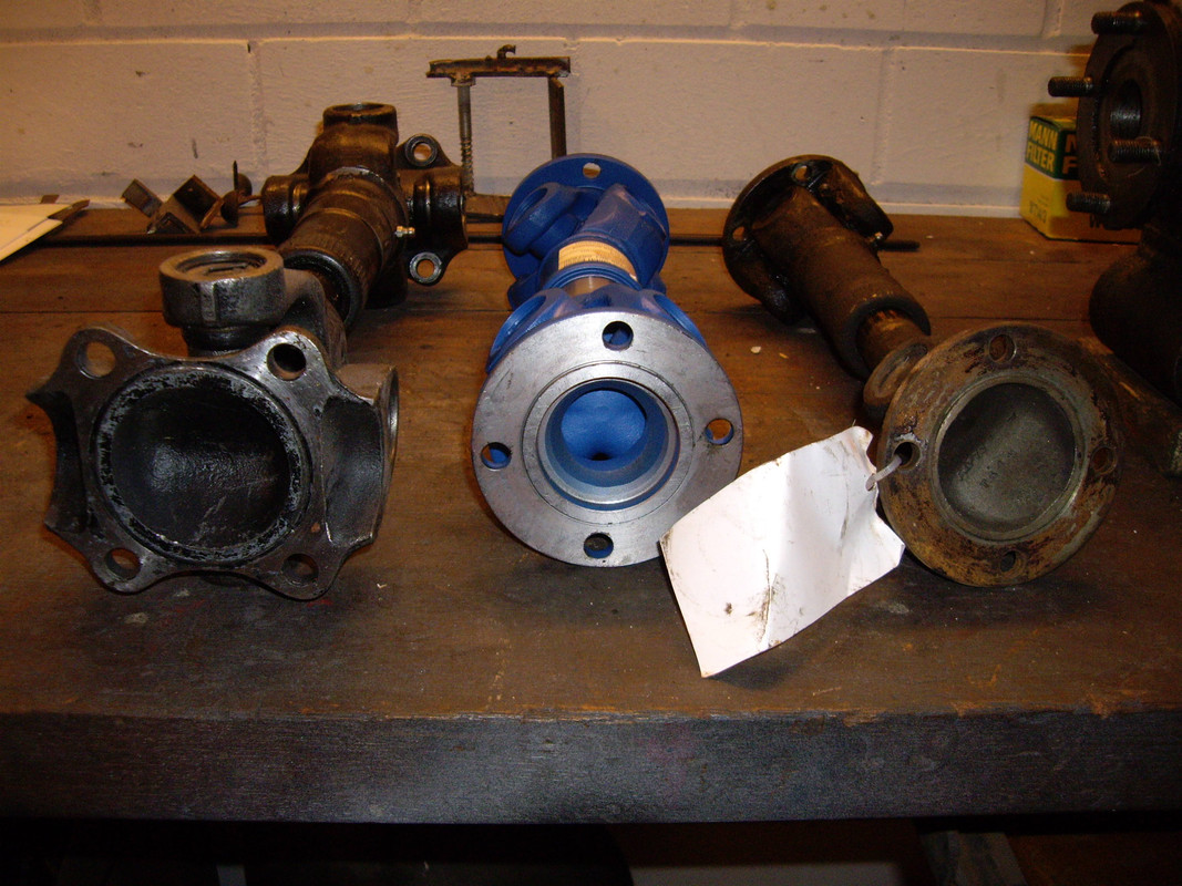

   And I got new drive shafts. The old were damaged and I wanted new drive shafts which are strong enough for the new engine. From left to right: original MK IV, new Aceca, original Aceca. I think I can tune up the engine a little bit before the new drive shafts say "no" [:)]

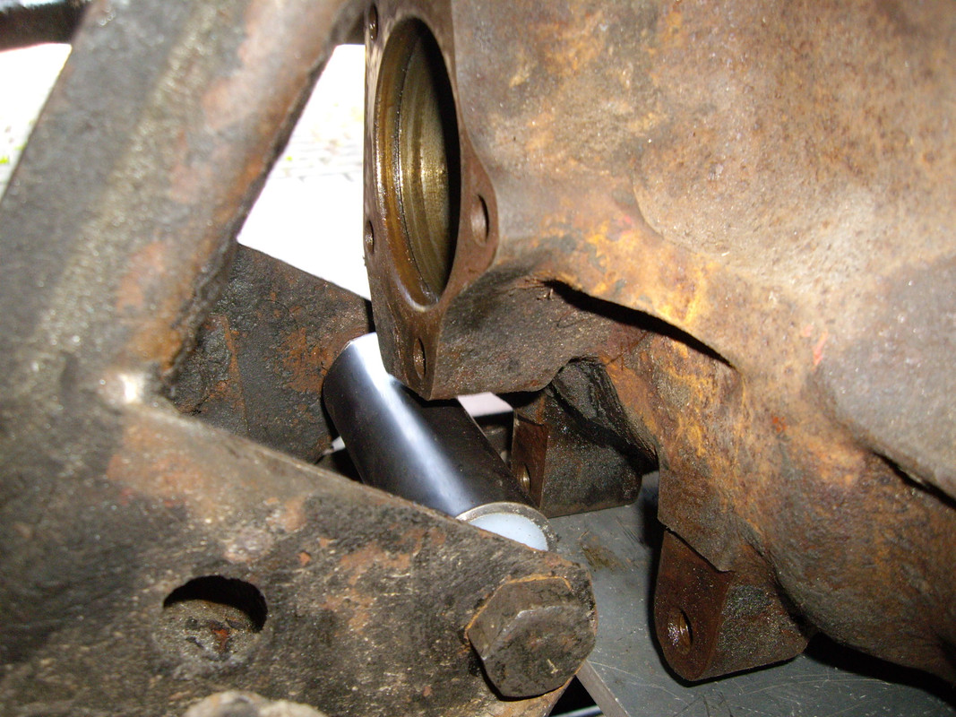

   Hi Luke,

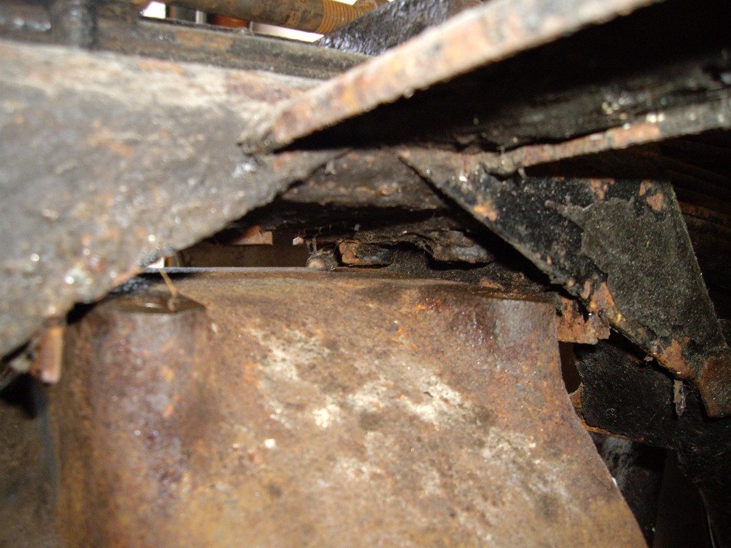

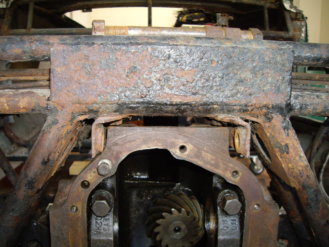

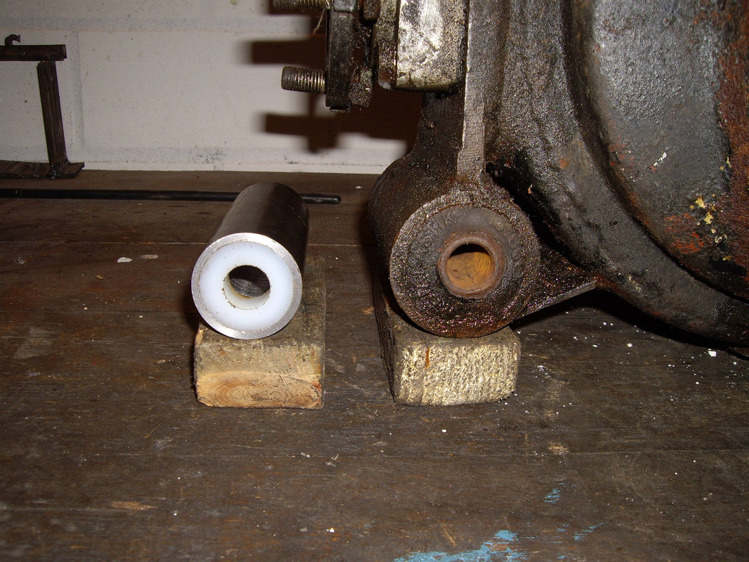

   thank you for your notice. Never mind that is too late for me because I couldn't use the original bushes anyway. The original bushes have a much bigger o.d. than the new one:
   (the white PE bush is only for construction purposes)

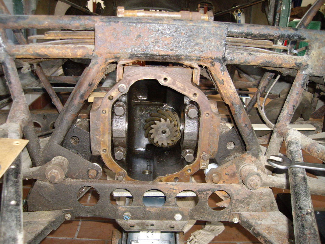

   The smaller bushes allows me to lower the differential case:

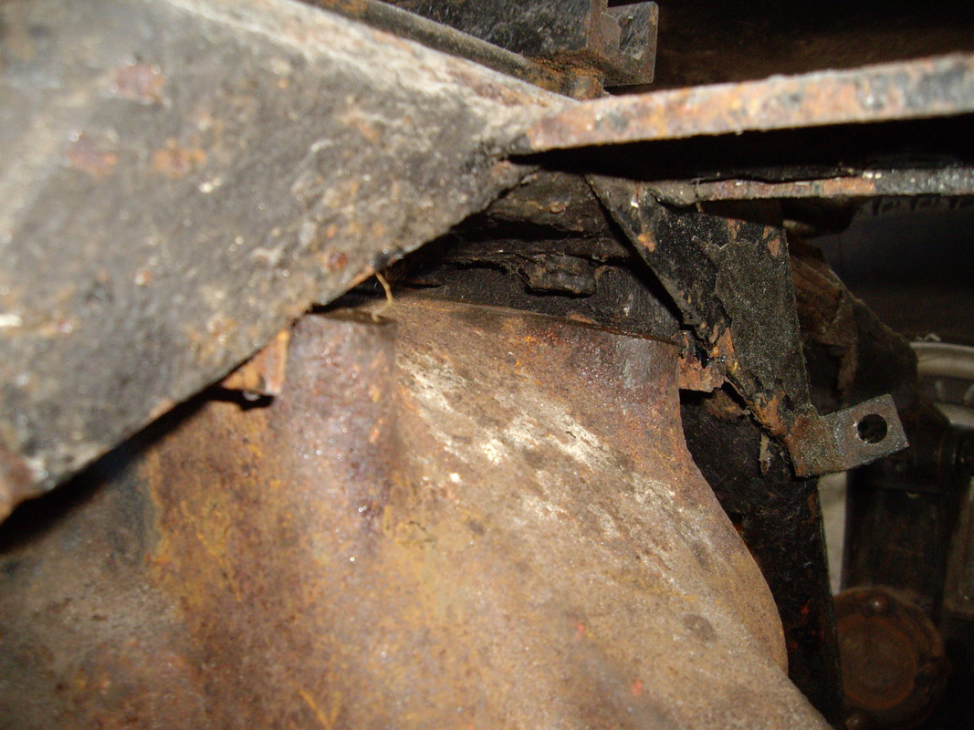

   and that's necessary because the JAG diff. case is much higher than the ENV case. I have nearly no space on top:
Currently, I have no idea how to make the upper bracket.

« Reply #83 on: June 04, 2012, 07:05:06 »
Hi,
   Could you please tell me where you got the "new" Aceca Axles?  I just blew up my second stub axle and the one's you have look like they are much more stout.
   Are the a direct replacement for the stock originals?  They looks so.
   Please advise ASAP!
   Thanks SO much for sharing this rebuild...Extremely helpful.

   Hi Rob,
   yes, they are a direct replacement with the only difference that the holes for the bolts are not 3/8" but M10, so they are 0,4 mm bigger. That should be ok or just use M10 bolts.
   I got them from these guys EDS Driveshaft. The article number is:
   03600151
   The detailed description:
   201.05
   4200.1052.0280
   FLM SAE 97/04-10,2
   LZ=280
   I guess that the 10,2 means the bolt diameter. They have a company in USA. Hope this helps. If not, please contact me.

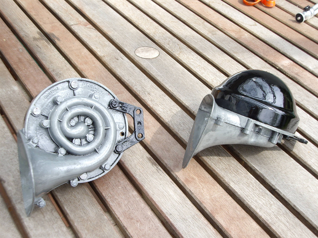

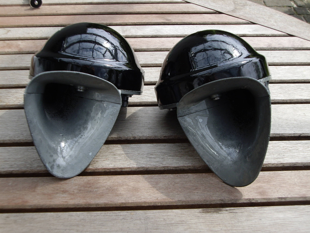

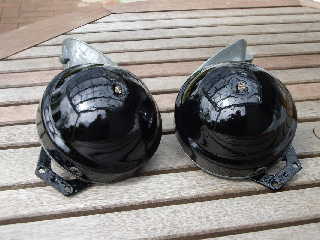

The horns still work after so many years.
   The body is powder coated the fantail is bead blasted and clear coated:

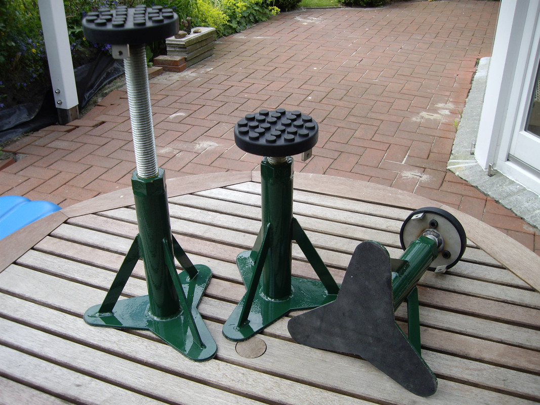

   I always dreamed of new stageless jacks. Now, I had the time to build a new set:

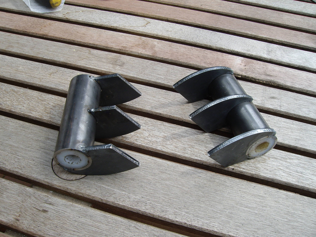

   And yes, I made some small progress on the differential brackets. I hope I can do more on that this weekend:
