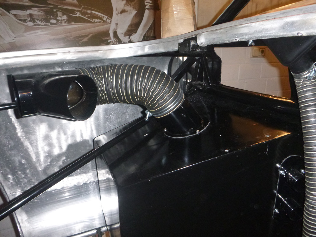

Working on the heater ducts in the foot box

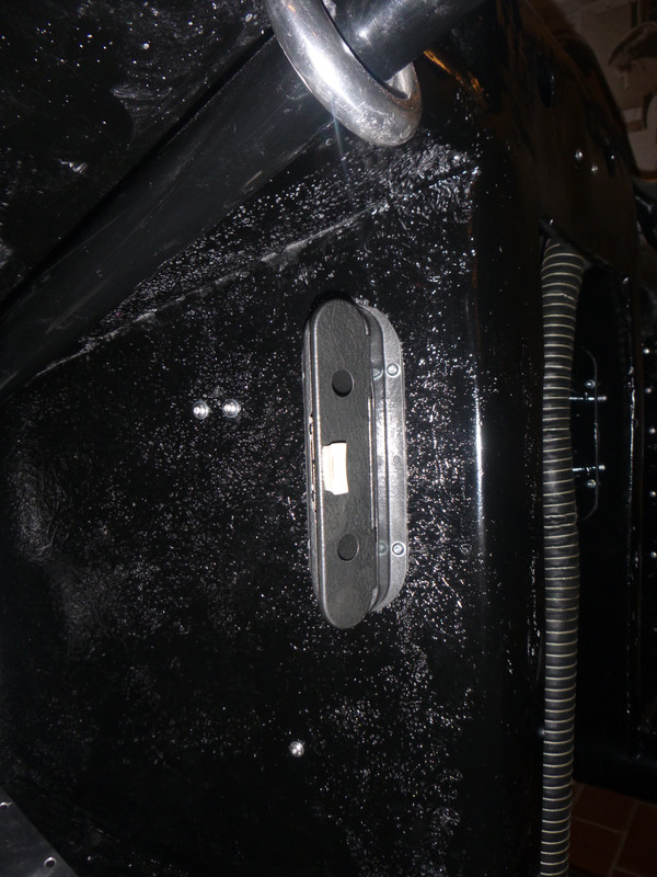

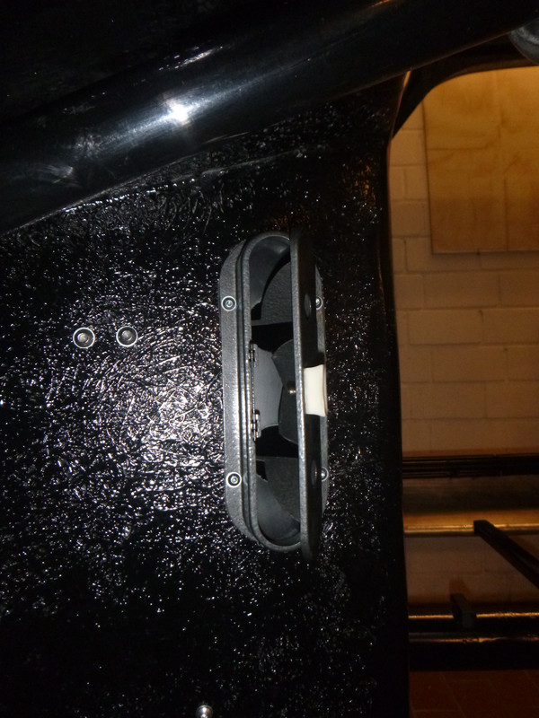

A new air duct for the foot box from an MG A. It's much bigger than the original one.
and also for the other side (not original but in summer it will be nice)
I constructed rubber seal for all of these parts in order to equalize the rough surface of the GRP foot box. You can see it. It is the clear line between the footbox and the air duct (same for the heater ducts).

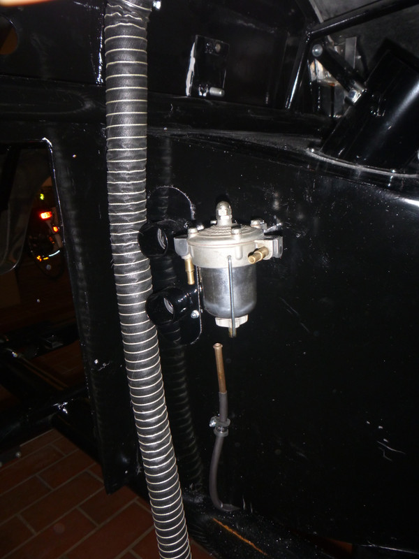

Installing the filter king
The pedalbox is connected to the brake lines
