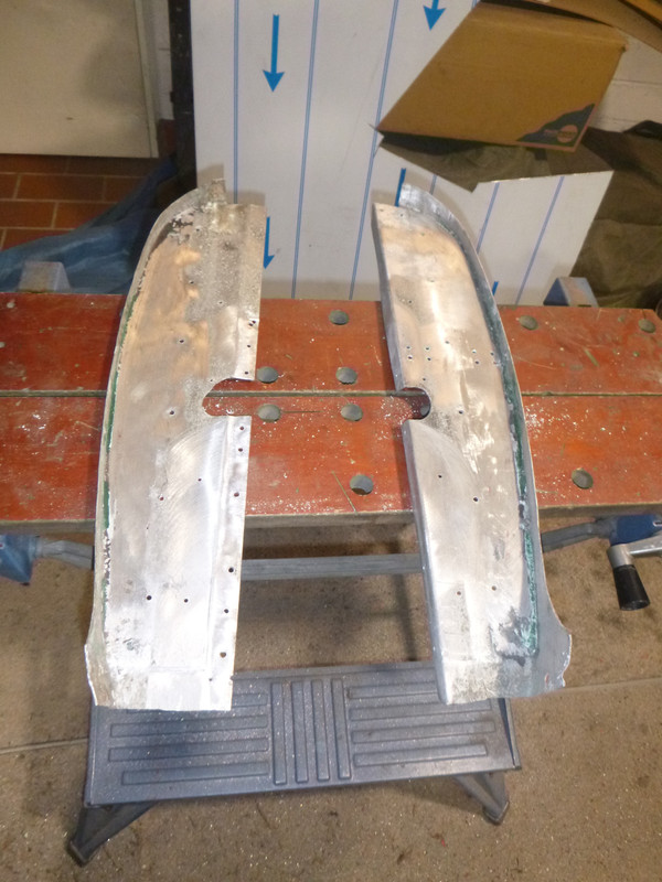

These are the panels below the A-column.
They have a lot of holes and I can't imagine that I will use all of them. So, new panels must be made.
Checking their fitment
