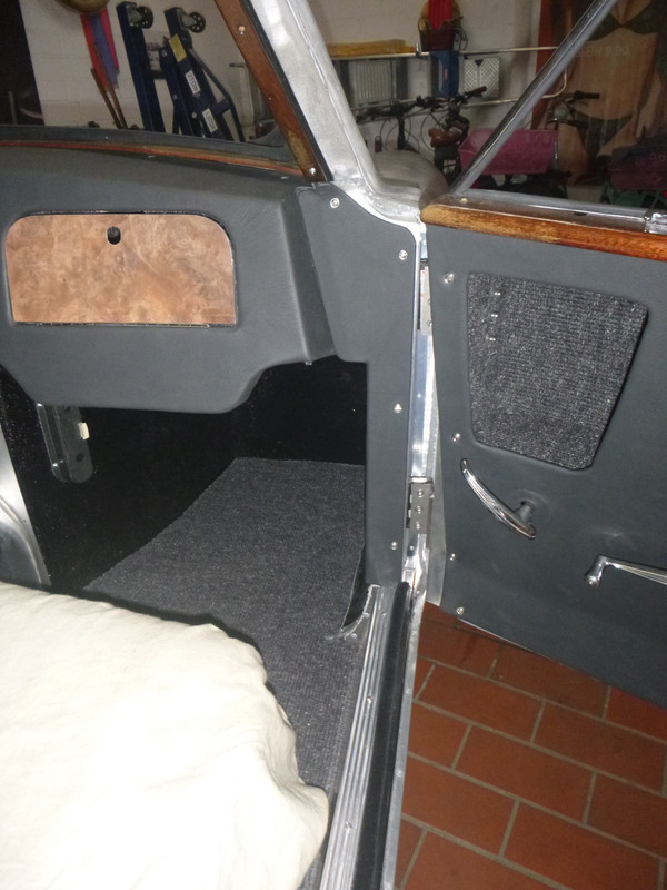

Wow, my last update was in summer. So, what happened during the last half year? Not so much. Nevertheless here are some pictures of the current status.
After covering the dashboard with leather I tried to do the same with the main instrument holder. This was really complicated. I had to do this work three times.
I tested the installation of additional front lamps
and cut carpet for the legroom
After that I had no excuse anymore not to start working on the doors. I postpone this for a quite long time because I had the feeling that this work will not very funny. And I wasn't disappointed  :(
The first problem was that I couldn't close the door when the inside leather cover was mounted.
Reason was that the rear lower edge of the door directed to far into the car.
After fixing that the doors closed again. The right door worked like a charme but the left door had problems with falling into the second stage of locking from time to time. The reason was the big shim under the gear wheel of the look had play and sometimes it slipped out of the central position and jammed the gear wheel. No way to fix this without opening the locking mechanism.
The reason why the shim could moved was that the guide bush was pushed to far inside and didn't guide the shim. After fixing this I assembled it but fixed the internal gear wheel with a screw just in case I have to reopen it again.
The connection of the lock with the drawbar is done by a special screw. It allows me to disconnect the mechanism and it has less play as the rivet solution.
After that I had to notice that my wife and I are to small for this car. We both had problems with the view straight on. The seats had to lift up. I produced distance bushes and covered them with carpet.
I spent most of my time trying to fit the side windows into the body. 1 mm here, 1° there and so one. A quite frustating job. After that the rear side windows had to fbe fitted. Again an awful job. And I could see that it was an awful job already in the past. A lot of holes in the B-pillar showed different attempts to mount the rear side windows. I closed them all and drilled new holes and used rivet nuts.
I am satisfied with the result on the left side
but the right side is not so good.
But I think this can only be fixed with a new rear side window frame (or a new body ...). I will keep it as it is. I checked a lot of Aceca pictures I collected during the last years and on many pictures I could see even more worse clearance.
To get the right alignment between the rear side window and the door window I lined the frame of the rear side window with 5 mm aluminium.
One little work during the last months was the installation of the outside mirror. I made a concave washer so the foot of the mirror hits the curve of the door.
